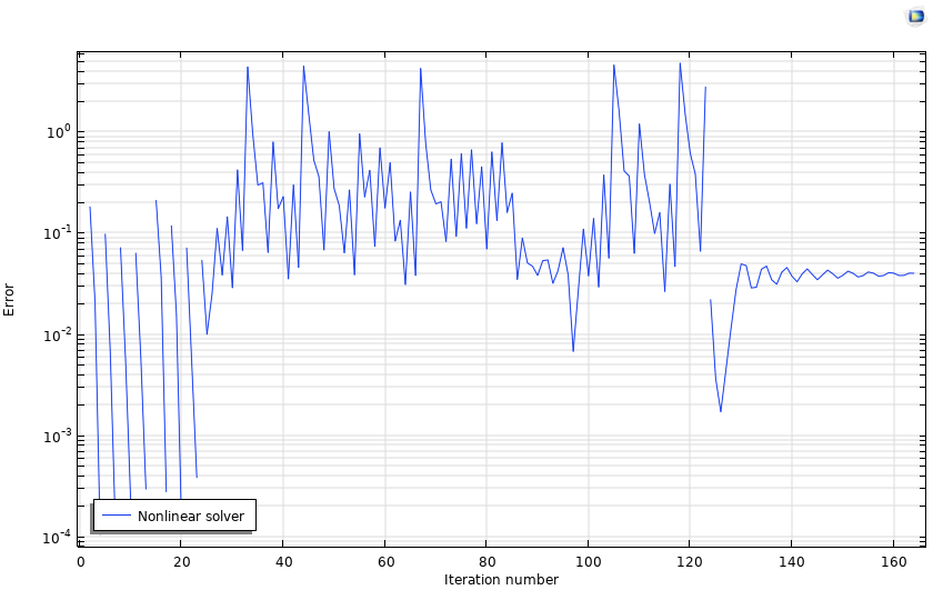

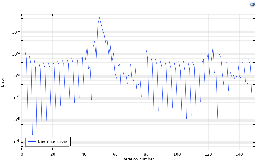

I have a model which has no problem in convergence for using solid interface. However, the shell interface does not converge even for a lower load condition.
I have tried to use Constant Netwon in the nonlinear solver. It doesn't make any difference compared to the default setting. Both non-structured and structured mesh encounter the same issue.
Is there any specific setting in solver needed to address the problem? Or my shell interface has mistakes?
Convergence plot for solid and shell are attached for reference. The COMSOL file is zipped.
Thank you for your reply. I have a model which has no problem in convergence for using solid interface. However, the shell interface does not converge even for a lower load condition. I have tried to use Constant Netwon in the nonlinear solver. It doesn't make any difference compared to the default setting. Both non-structured and structured mesh encounter the same issue. Is there any specific setting in solver needed to address the problem? Or my shell interface has mistakes? Convergence plot for solid and shell are attached for reference. The COMSOL file is zipped.

I think you would to contact support to get help with this. But it is probably related to snap-through phenomena, where the solid model may happen to capture the second (postbuckling) branch, even though the solution is force controlled.
Henrik Sönnerlind
COMSOL
