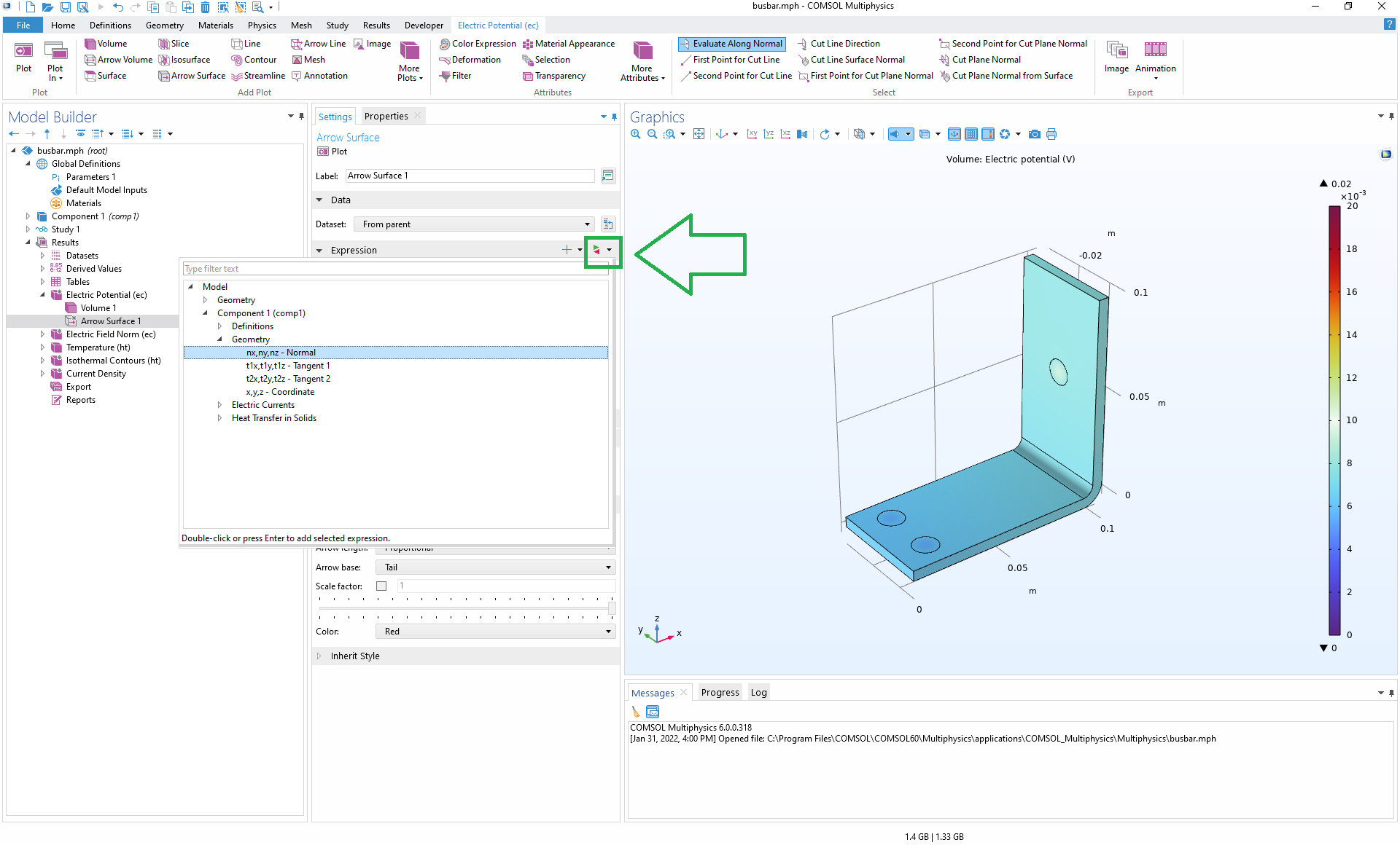

Nowadays, another very effective way of finding the name of predefined quantities is to, in the GUI itself, look at the postprocessing quantities available for plotting. See my attached screenshot: by pretending I want to generate an arrow plot on a geometry's surfaces, I can quickly determine that the normal vector is (nx, ny, nz).
Yet another approach is to do Ctrl+F in the GUI and search for "normal vector": if that string appears in the description of any quantity in any of the Settings windows of your model, this will find it!
