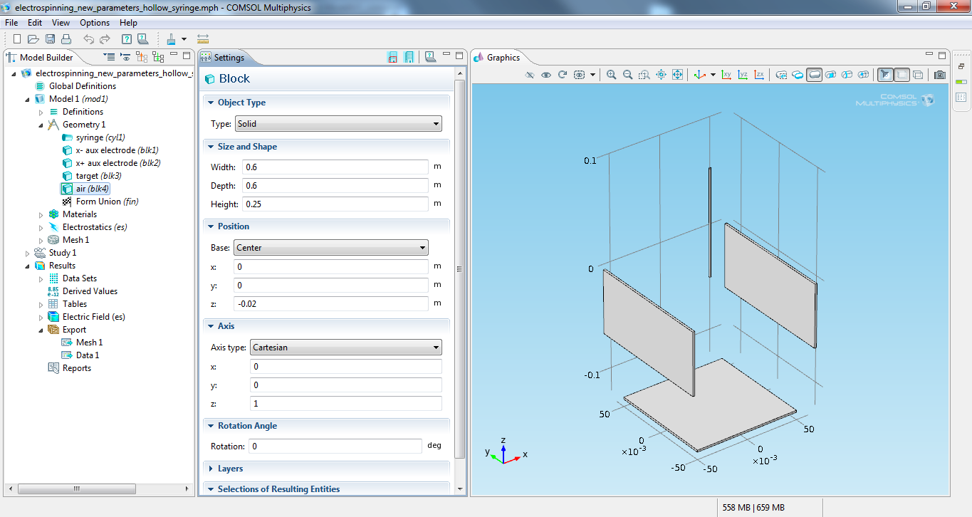

rectangular grounded plate
hollow cylinder with electric potential above the ground plate, distance ~20 cm
That's basically it! there are two more plates further away, but that shouldn't be the problem...

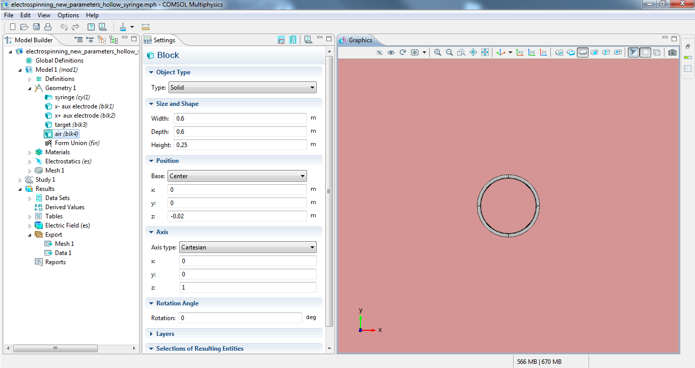

Edit: Maybe some screenshots can clarify the whole problem. Screen1 is just an overview, screen2 a top view to show the cylinder in detail. A big block of air surrounding the whole thing is hidden both times to makes everything else visible.

So, I slightly modified my geometry: filling the cylinder and moving it up a bit helped a little. The differences in the electric field are a little lower now (still like 3-4 order of magnitude). Could that be for the strong field inside the cylinder? Any ideas?
