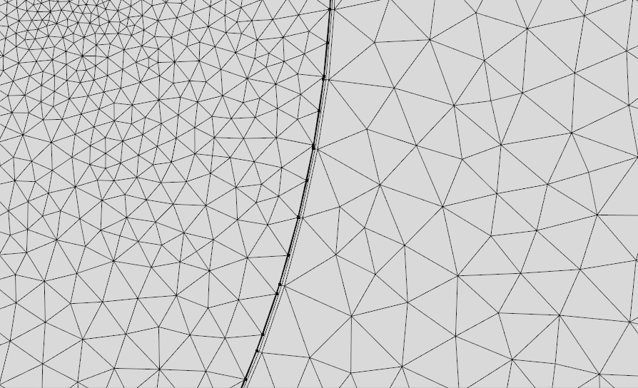

When using Rotating Machinery, the mesh doesn't look pretty (see attached image, with Rotating Domain on the left, identity pair being the line in the middle). The mesh doesn't line up properly, is that a problem? I added boundary layers and the solution improved (no longer an abrupt change of regime), but how much should I trust this?

I haven't mixed the two Physics yet, just looking into how each one works. The 'fixed' circle looks to me like a problem, if I am to embed the rotating circle (containing the flap) inside pipe flow. I would have to provide a fine mesh, else the resulting wake of the flap would smash into a 'regular' mesh upon exiting the rotating domain. And a meaningful flap would require a circle with a radius ~= the pipe height (and thus, the circle would almost touch the pipe boundaries). This is my fear, as I don't really know how it would work out.
