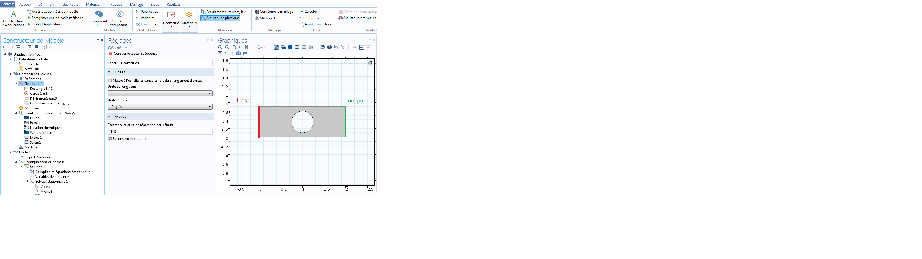

I have join a screenshot of my geometry, it's a basic one but I need it. Eventually, my initial value is the mach on x-axis : M=4. The temperature doesn't change during the fluid flow.
