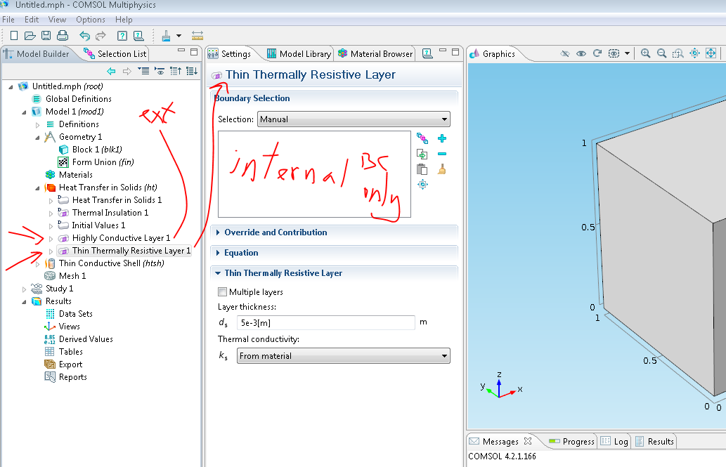

I have in HT "Thin Conductive layer" for internal or external boundaries, and "Thin thermal layer" for internal boundaries only
No need for shell element hysics in addition, I would typically use a htsh with a structural "shell" model
Following up on your response, I am wondering if the "thin thermal layer" you mentioned is the same as "thin thermally resistive layers" in 4.2? Also, how is it different from "highly conductive layer"? I see from its equation that it has up and down direction which probably explains why it is for internal boundaries only. The doubt I have is whether or not I can make the boundaries (assigned to either "thin thermally resistive layer" or "highly conductive layer") either highly conductive or resistive by changing the value of thermal conductivity?

its my typo I do not believe it has changed with the version (I have 4.2a .166)
The thin thermally resistive layer adds a temperature step along the normal of the boundary.
The thin highly conductive layer adds a thin layer that conduct along the boundary
careful not to add both to a common (union) boundary, my version fails with an error
If you are using assembly mode, then note that the pair continuity, pair thin thermally resistive layer, pair highly conductive layer can all be added but they interfer, and from my understanding only one should be enbled at each time
