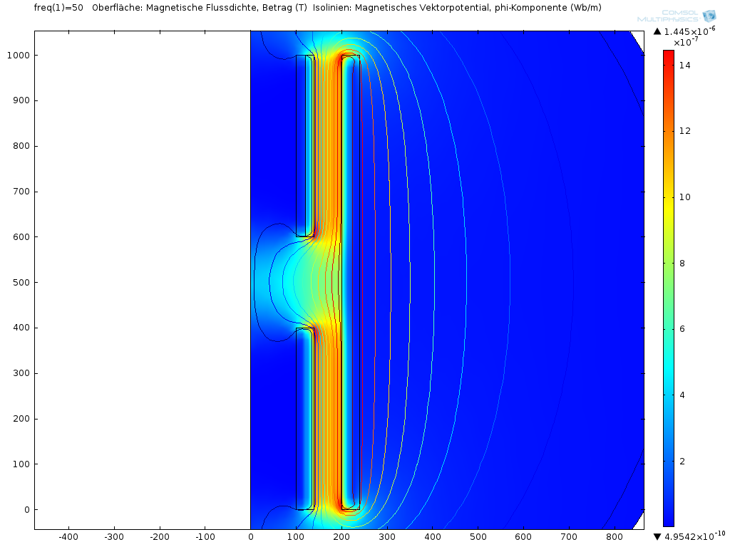

Dear Ivar,
I want to split a solid conductor (as a winding) into parts in axisymmetric environment and study that in frequency domain. In this way a thin gap (or electrical insulation) should be represented between each neighboring sections. The model is in Magnetic Fields (mf) physics. I tried “thin low permeability gap” boundary condition but unfortunately it doesn’t work. In my simulations, it seems that the boundaries don’t have any effect on calculations. Please find attached my mph file.

Dear Ivar,
Thank you for your precious information. As you can see in the new *.mph attached file, i implemented all your aforementioned points, but the "thin low permeability" boundary condition still doesn't have any effect on calculations.
I expect that by defining this boundary the first winding divides into two separate parts so i can see induced currents separately in both parts. But when you look at the current density (phi component) it seems that the software still considers the first winding as a continuous solid winding (please correct me if i am wrong).
Maybe i am using an inappropriate feature to have an "electrical insulation layer" between two solid windings. Let me ask my question in another way and i would really appreciate it if you can help me with my problem:
what do you suggest me to do to model an "electrical insulation layer" which electrically separate a solid winding into two parts?

indeed not sure why I see no difference with or without your boundary layer (and the suppression of the air boundary definition). One other way to study this behaviour is to add two "layers of i.e.18 mm on your first rectangle (select left and right)
then to model the air as a "true" thin air domain and then to compare the results (mesh the Cu + thin layer as tri before the boundary layer)
But I do not see any major difference there, so I wonder if it is not correct

I'm facing the same problem as Saeed. I need to model an electical separation layer between conductors, but the "thin low permeability " boundary condution has no effect on results.
I solved the problem by creating a physical thin air layer between the conductors, that of course requires a very fine mesh. But I still don't understand why the original b.c. doesn't wotk.

in MEF you can check, if Transition Boundary Condition is working for you.
For frequency domain I have modified your example (MEF is not for transient).
