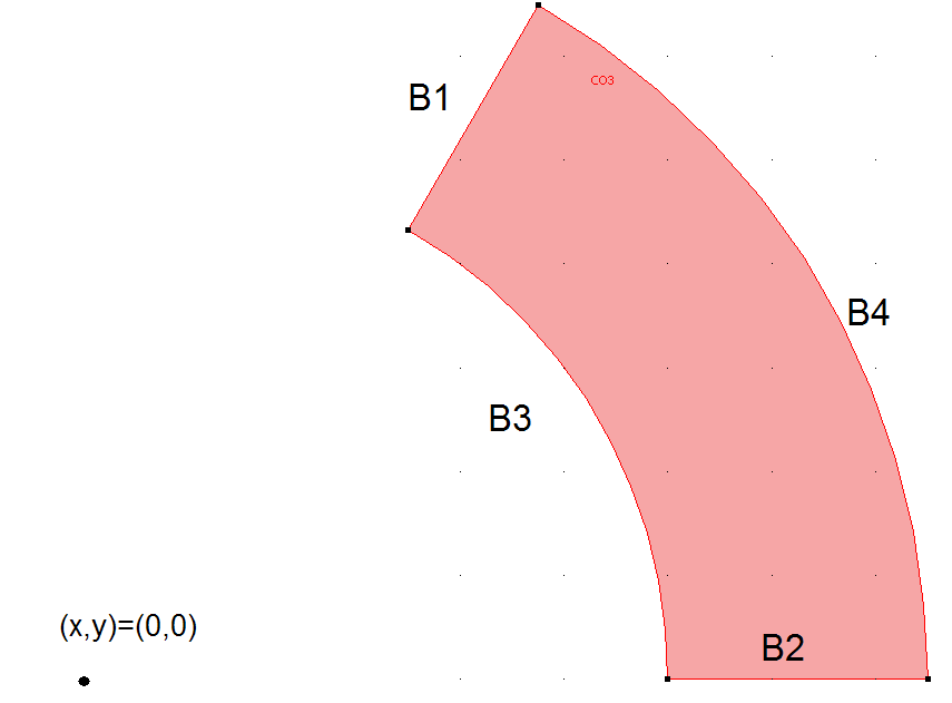

In my 2D cylindrical structural mechanics model, I am going to simulate almost a quarter of a rubber-like (hyperelastic) material tube (please see the attached picture) and stretch it circumferentially to make it a half tube. I have successfully done this in Cartesian coordinate, however, I prefer to do that in cylindrical system too.
In my V4.2 COMSOL, I have defined a cylindrical coordinate system, but I have problem correctly defining the boundary conditions. In the boundary condition menu, first I selected the Cylindrical coordinate system. For boundary # 3, the displacement in r-direction should be “r-R”, where r is the final radius (unknown) and R is initial radius, which is known. Of course I enter “sys2.r – R” as my Cyl. Coord. Sys. is sys2.
When I enter the expression “sys2.r – R”, the program gives me a warning indicating that R is not a defined variable. So I decided to replace R with sqrt(X^2+Y^2). This resolves the error, but the solution does not converge, which I believe may be due to this expression rather than other solution parameters that may improve the convergence. I have two issues:
1- Although I do not get a warning when I use X and Y when using cyl. coord. sys, I hesitate to use sqrt(X^2+Y^2) because I have already selected Cyl. Coord system, while X and Y are defined in Global coord. Sys.
2- I wonder if I need to use sqrt(x^2+y^2) (i.e. use spatial coord sys) instead of sqrt(X^2+Y^2) (reference coord. Sys), because the frame type was selected Spatial when I was defining the cyl. coord sys. If I didn’t select Spatial, the cyl. Coord. Sys. wouldn’t be available in the physics menu. However, I believe that the reference coord system should be used (i.e. R=sqrt(X^2+Y^2) ).

I beleive you are getting confused with the frames (I too get them always mixed up so I must recheck the convention regularly ;) when you define your cylindrical coordinates, you define the frame it applies on: Material frame the original geoemtry" or the spatial frame i.e. the deformed geoemtry, check carefully the doc.
then define your variables, you can make a "Definitions" variable my_R =sqrt(X^2+Y^2) and my_r=sqrt(x^2+y^2) then when you write "my_r-my_R" for any boundary or domain you will get the difference between the deformed and the undeformed shape (for a linear case it should also be close to "sqrt(u^2+v^2)" )
