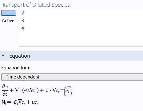

Need to modify Equation(Transport of Diluted Species)
Hello, I am currently doing a research project and I need to modify an equation. I want the 'R' value on the right hand side to be 0.
I have attached a photo with the equation I need to modify.

Magnus Ringh COMSOL Employee
Posted: 6 years ago 03.10.2018, 06:50 GMT-4
By default, the right-hand side is 0. It is only if you add a Reaction node and specify a nonzero reaction rate that you will have a reaction in the computed solution (in the domains where the Reaction node is active)
Best regards, Magnus Ringh, COMSOL
