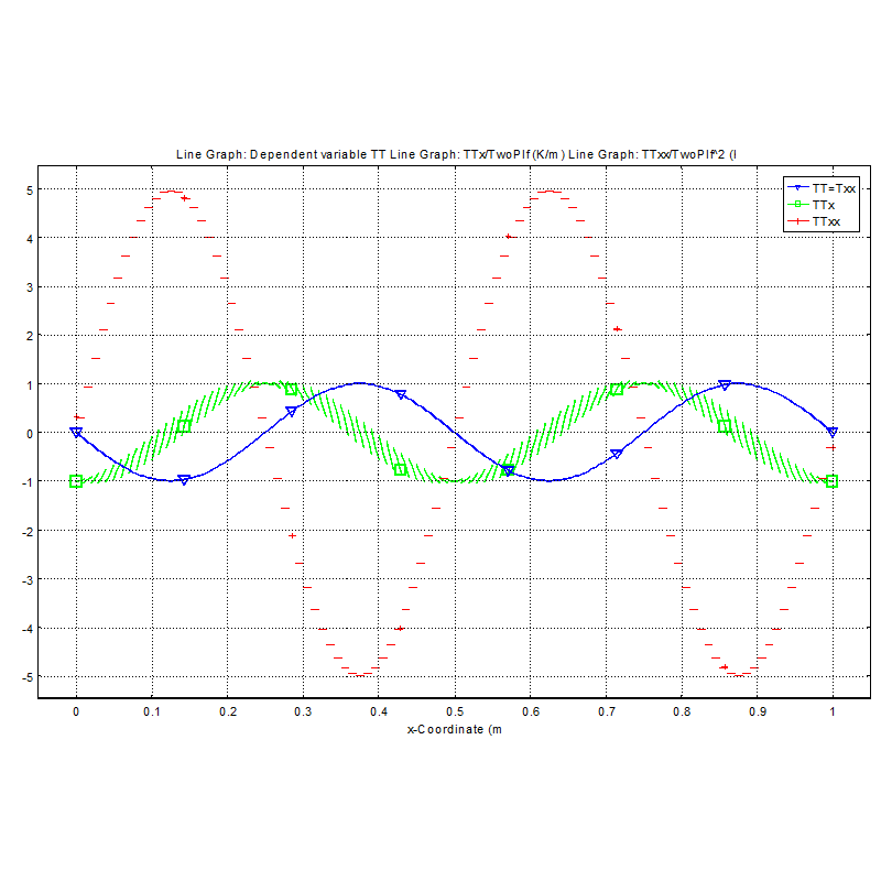

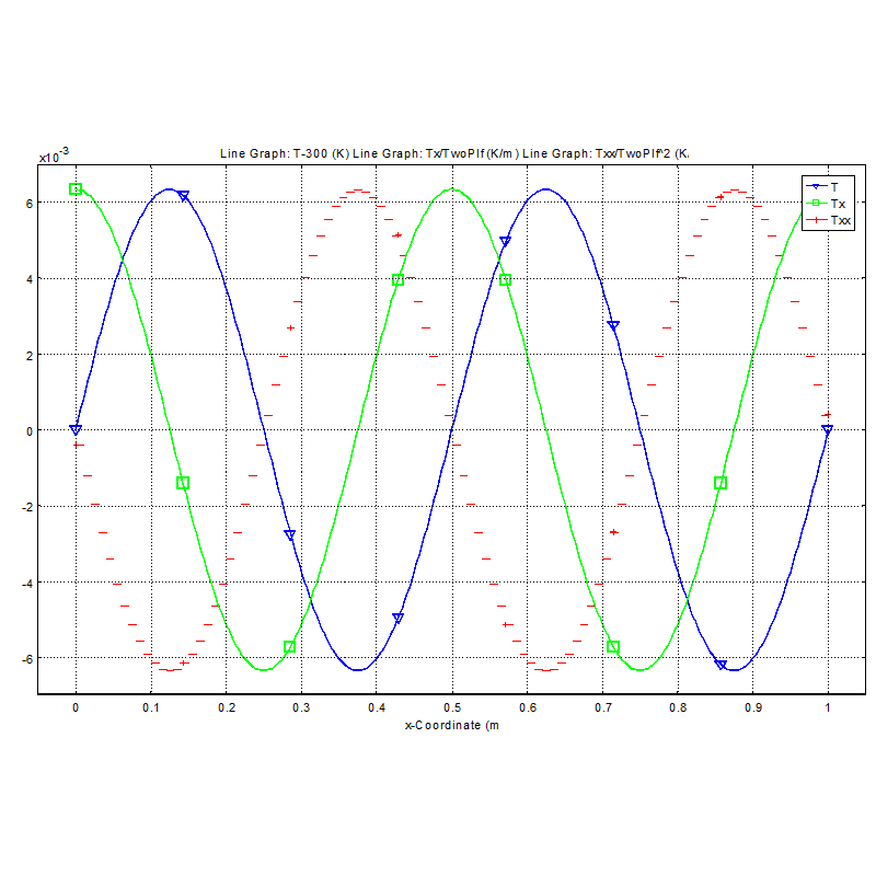

In v4.1.0.85 it gives this:
OK up to third derivative, 4th has a scaling issue ?
each derivative is divided by 2*pi*freq for normalization.
Why is TT=PDE of Txx renormalized to 1? ===> it's not, I was too quick, I forgot about my renormalization ;)
But why is TTxx at *5 the expected amplitude ===> not understood
Having (less?) fun COMSOLing
indeed, the 4th derivation is too high (approx. 5 times). If I switch to quartic elements for 'T', there is no 'scaling' issue anymore. -> Txxxx/((2*pi*f)^4)=T
So it's a numeric issue?!?
That's what you mentioned?
Having (even more!) fun COMSOLing ;)
I agree using quadratics you can get 4th derivative, but do you then really need "TT", the second PDE solution
This does not fully convince me (yet) for the second PDE I'm using for TT
what do you mean? I never used 'TT'. My new dependent variable for my PDE is 'u'. It's a converting problem from 3.5 to 4.1?
Even though you use quartics, you can't get the 4th derivative out of the original variable 'T', because 'd(Txx,x)' and 'd(d(Txx,x),x)' are always zero. Therefore I have to introduce a new PDE ('u').

Sorry, when translating to 4.1 I mixed up u and u2, so I renamed them T and TT. Then as I was playing with the shape functions of u2 or my TT I did not manage to improve things, what I forgot was that the source is u (or my T) and I did only leave it as a quadratic.
Now it could be that in V4 the higher derivatives with d(uxx,x) are calculated correctly, I will have to check so one do not need to add the PDE, it would be rather logical (for me) that a higher order shape function allows to take higher derivatives without any additional PDE artifact
