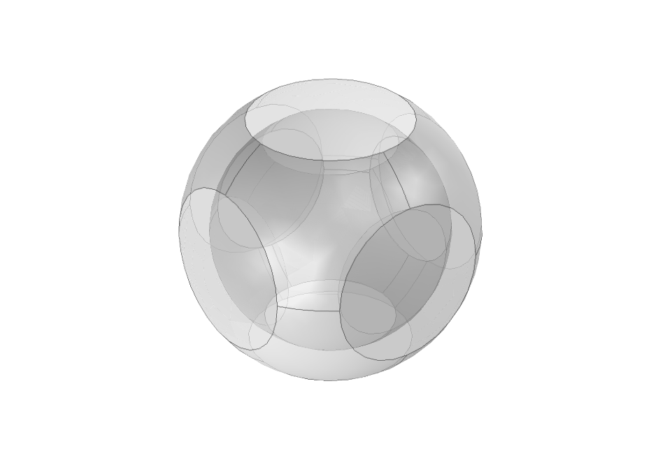

I have a model using general form PDE with different domains governed by PDEs with a different flux. One domain is inside the other and it is in 3D (see attached picture). I need a condition across the interior boundary such that:
