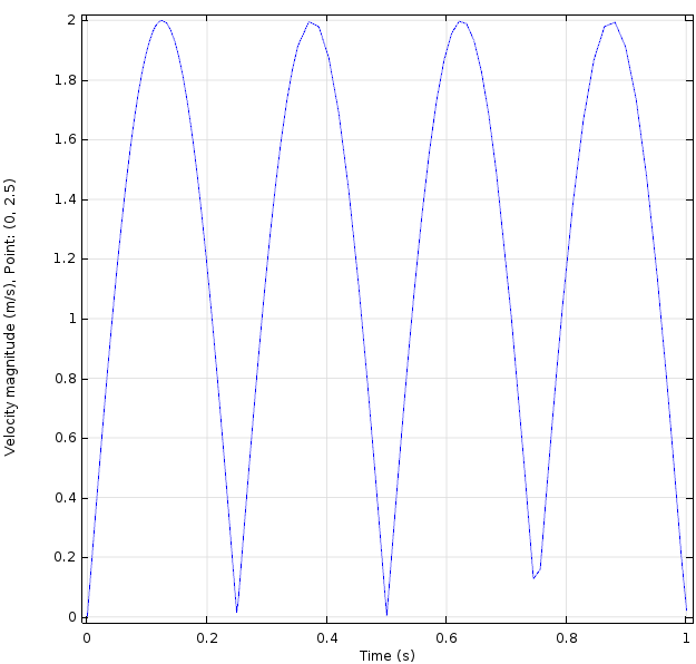

I would like to set up an inlet that produces oscillating flow (going from positive values to negative ones) in my model. When I add the expression
2*sin(4*pi*t[1/s])
to the inlet velocity field I get out only the absolute value of that expression. See the attached picture.
How can I get both positive and negative values for velocity at an inlet?

Hello Ben,
You are plotting the "Velocity magnitude".
Hello Ben, You are plotting the "Velocity magnitude". Jeff

I'm glad it was something so simple.
Thanks for the prompt help!
I'm glad it was something so simple. Thanks for the prompt help!
