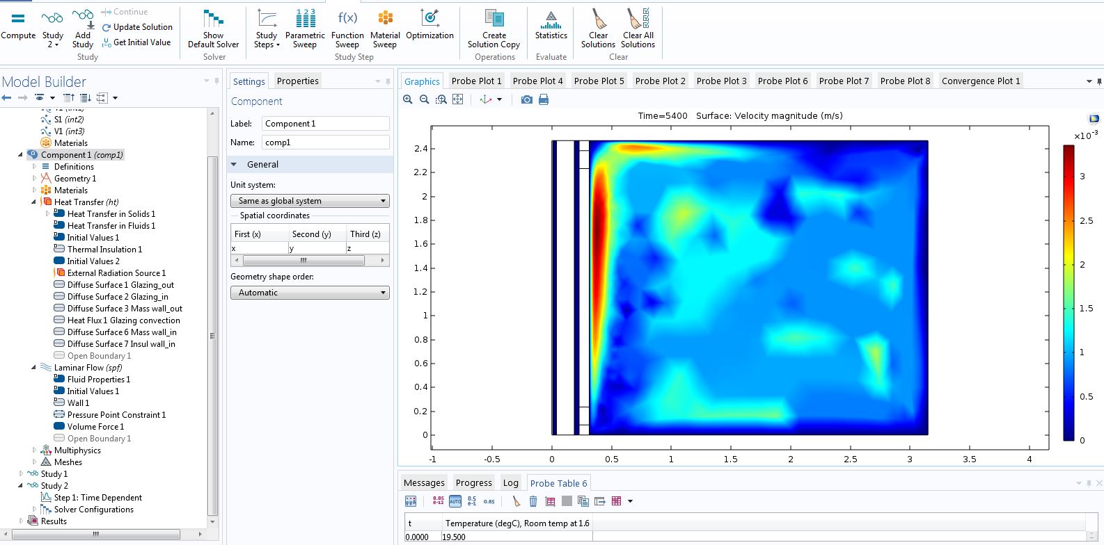

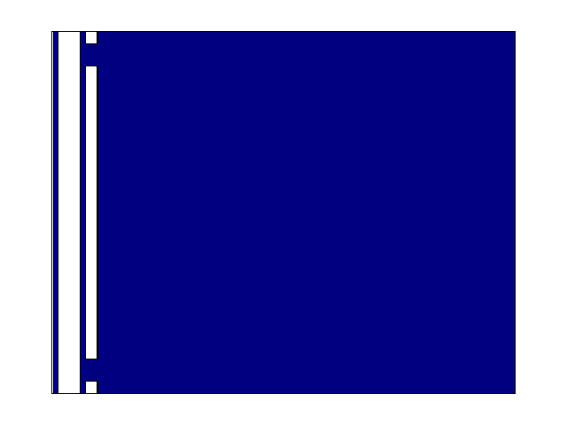

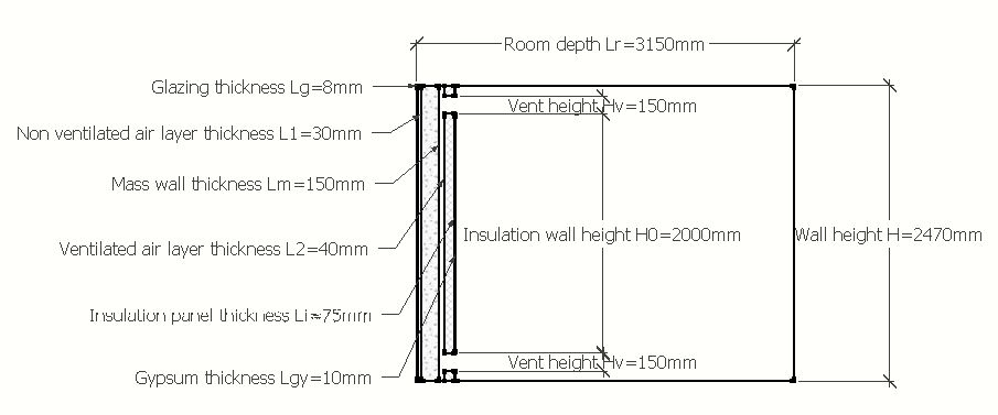

I'm building a time dependent model of passive heating wall called composite Trombe wall in COMSOL 5.1 with heat transfer and laminar flow modules. The geometry and model set up files are attached here, along with a flash gif. file to show how the air flows in the system.
To avoid over-heating in the summer and air reverse-flow in the winter, I want to control both the upper and lower vents' opening. As soon as there is a reverse flow for winter (warm air leaves room), or indoor temperature rising above 22 degree in summer, those vents will be closed.
