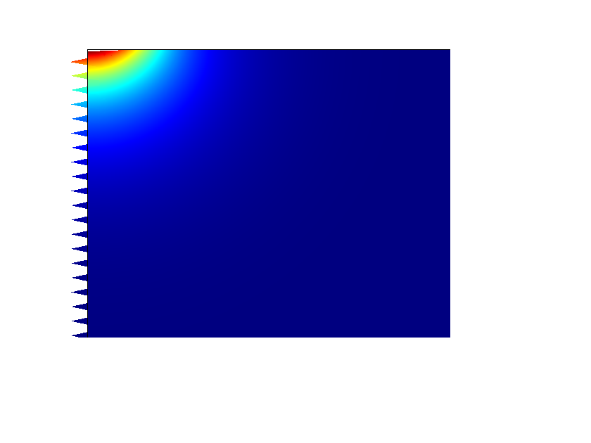

I'm trying to build a 2d-axis model of laser heating process, which will melt the powder bed.
The free-surface will deform according to the surface tension and mass loss due to vaporization. Here I use the ALE moving mesh to account the free-surface deformation. I set the boundary condition so that the mesh displacement happens on the boundary at the top. And the axis boundary on the left side only has displacement in z-direction.
But I encounter a strange problem of mesh deformation. As shown in the figure, the mesh will cross the axis boundary. A series of strange mesh deformation happened. However, I have set the mesh displacement of the axis boundary to zero at r-direction. Sometimes, this kind of mesh deformation also happens on the boundary of the right side, whose mesh displacement is also zero in r-direction.
I have no idea how this problem happens.
I'm sure all the domain, boundary conditions are propre.
Have this kind of problem happened to you in ALE moving mesh modeling.
