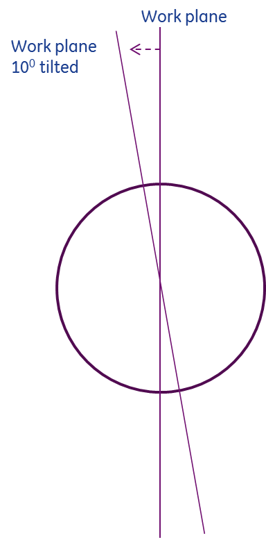

Hello, I have been working to create a 3D geometry and stuck in the problem of tilting the work plane.
As a way to create a one of orthogonal plane to work on, I chose quick in plane type and I wanted to tilt the plane to a certain degree.
as a goal, I want to create a sheet of aluminum plate attached to the cylinder with 10 degree tilted (such as 11 o'clock location). However, this only gives an option of rotation only. I appreciate any comments. for the detail information, picture describing the problem is attached.
