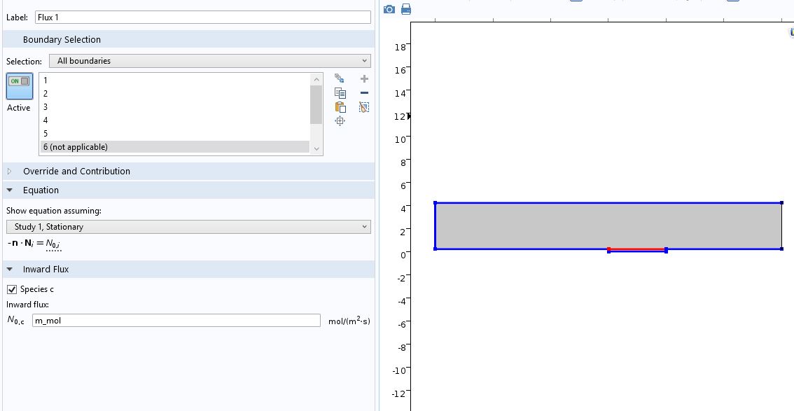

I don't usually use those particular settings, but I can guess what is happening.
Internal boundaries are not in the default set; they appear as inapplicable (and act as continuity) in the default set. So you usually have to create a new boundary condition if you want something other than continuity there. In the Model Builder, under Component, find the physics-related heading (e.g., "Electromagnetic Waves" or whatever physics you are using. Right-click on that, to bring up a menu, which will include various boundary conditions to choose from. Choose one of those, corresponding to the condition you want to set on this particular boundary. This will generate a whole new entry in the list under the physics. Left-click on that entry, Now select the boundary you want from the graphics window and right-click to cause it to be loaded it into the selection box.
